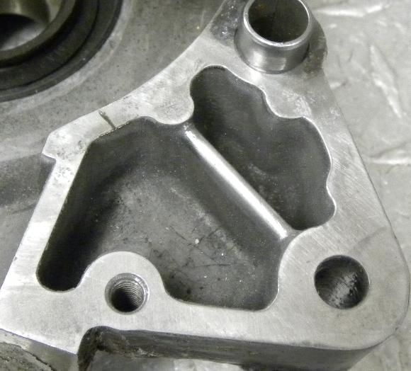

First, you want to clean the mating surface so you can see what you have to work with.
As you can see, this case has a bunch of gasket material left over from disassembly.
So, a quick trip to the wire wheel (I use a fine wire wheel as the coarse wheel can do damage) will remove the gasket material and expose what's underneath.
Some guys like to use a razor scraper to remove the gasket material but you need to be careful as you can scratch up the surface very easily.
Regardless of the method you use, the mating surface should be very clean when you are done.

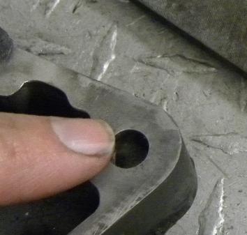

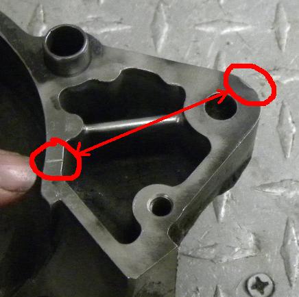

Once done, it reveals that we have two problems.
We have a scratch on the left side and the case was sticking out a bit on the right side.

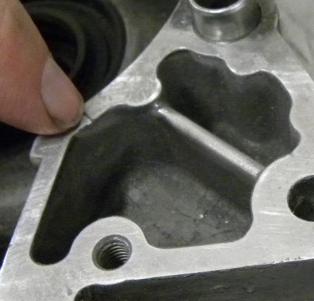

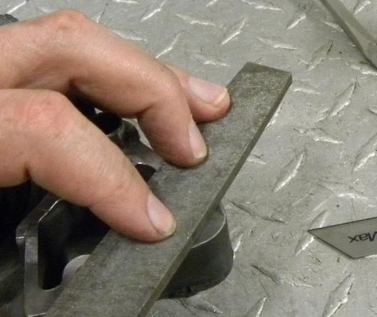

So, I fixed the right side using a fine file.
All you need to do is keep the file flat while gently moving it back and forth until the protruded surface is smooth with the rest of the mating surface.
You can feel it grabbing on the protrusion.
As soon as the protrusion is gone you will feel the file run smoothly over the entire surface.
Remember, you don't want to press very hard and you don't want to remove any of the mating surface causing dips or valleys.

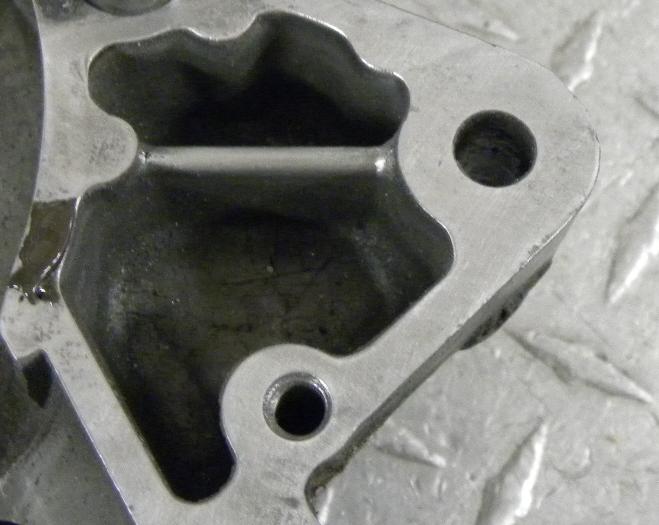

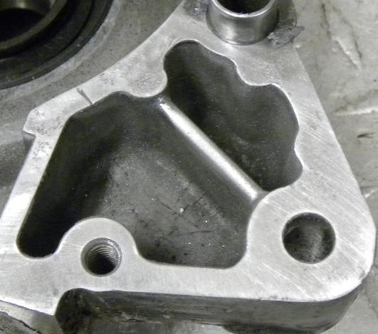

When you are done the mating surface should look something like this:

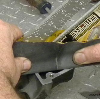

Once that is done I take a very flat surface with some 500 grit sandpaper and run it gently over the affected area.
Normally I use my metal sanding block but I couldn't find it so I used a small framing square :)
It only takes a few seconds to get a surface that looks like this:
Now that it is all cleaned up you can really see that scratch.

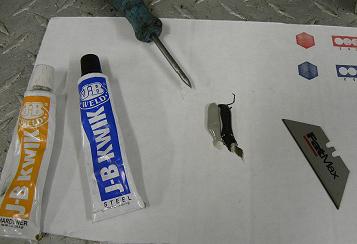

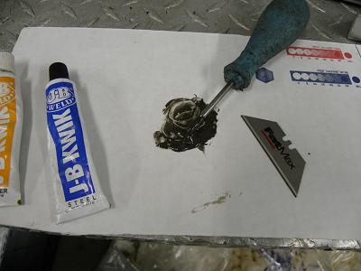

Next, you will need to JB-Weld, a razor, and something to mix the JB-Weld on and with.
Something like this.
The mixing surface should be really clean.
If I had the option I would use a flat metallic, glass, or plastic surface.
Squeeze out equal parts of the JB-Weld and mix thoroughly.
Once it is thoroughly mixed apply a dab to the scratch.
Next, take your razor and while holding it at 90 degrees to the direction of the scratch slowly pull the razor toward you while holding it flat to the mating surface.
After scraping with the razor blade you should have something that looks like this.
