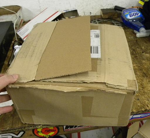

Here is what I received back from them.
pinsonnault racing 1.JPG (36.76 KiB) Viewed 19616 times

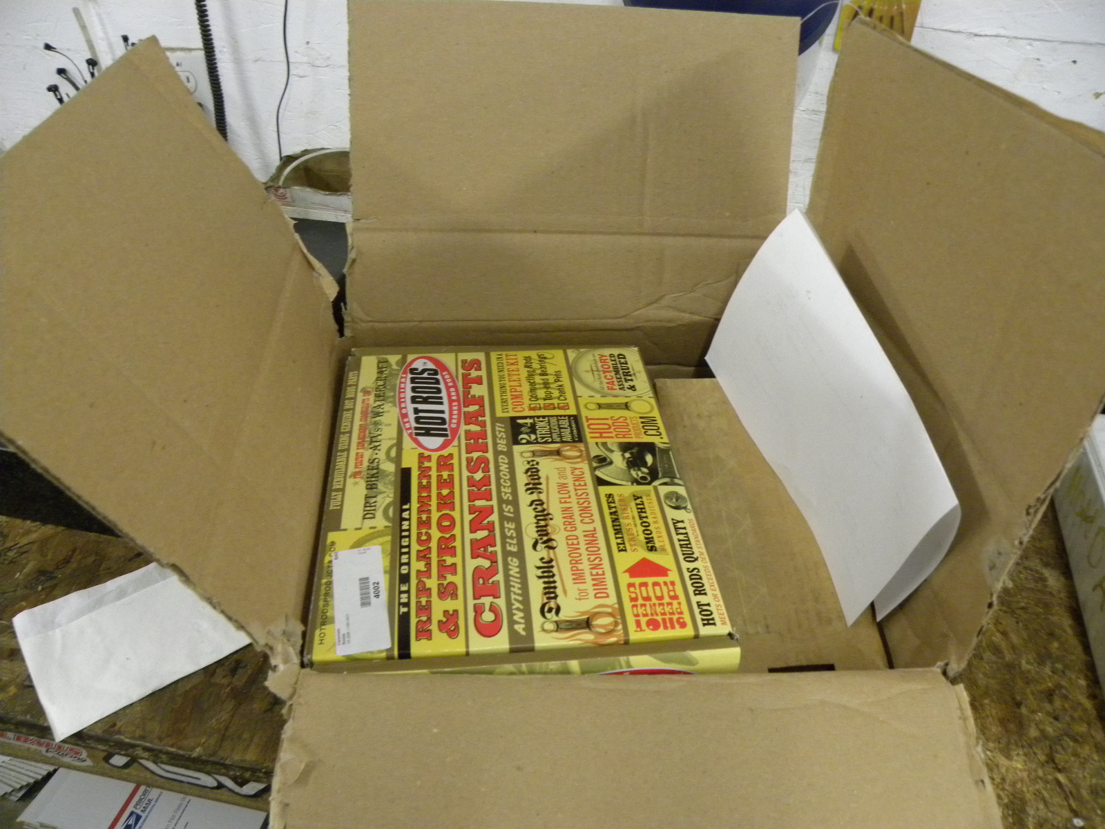

Ah ha!
A box within a box is always a good sign.
Due to their weight, crank shafts are easy to bend up the threaded ends during shipment.
If you look at the inner box you will see that it came from Hot Rods.
Nothing wrong with using a competitors box as we do it all the time. :lol:
But believe me, Hot Rods wishes they could turn a product out this nice.

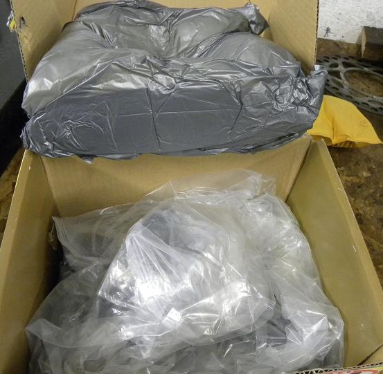

After opening the box we discovered that the crank is wrapped in plastic and foam fitted to the box.
Nice..

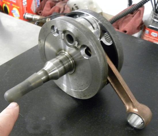

After removing the plastic I noticed that the threaded end is covered by a rubber end cover.
This just keeps getting better.
pinsonnault racing 4.JPG (33.18 KiB) Viewed 19615 times
The next thing I notice is the welds.
First class job.
Looks like a machine did it.

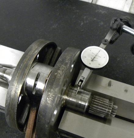

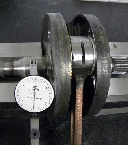

After checking the radial runout, and the rod to crank clearance, I put the crank into my V blocks, set up my Best Test indicator, sprayed a little Tri Flow onto the journals to prevent any potential sticky readings.
With this indicator I can see imperfections as small as 1/10 of 1000th of an inch, or .0001", probably less.
Here is the set up.
pinsonnault racing 5.JPG (31.46 KiB) Viewed 19615 times
pinsonnault racing 6.JPG (27.55 KiB) Viewed 19615 times
How much runout was there?
pinsonnault racing 8.JPG (12.36 KiB) Viewed 19615 times
ZERO!
Another person (Motorrad) did this same test and said that he thought his indicator was broke because his readings were so perfect.
Well, I had the same experience.
As I spun the crank around I expected to see .0001 somewhere.
I didn't.
In fact I had to keep pulling my indicator away from the journals to be sure that it was actually touching the journals.
I have no way of measuring it more accurately and I have to say that in my view it is as close to perfect as you can get.
