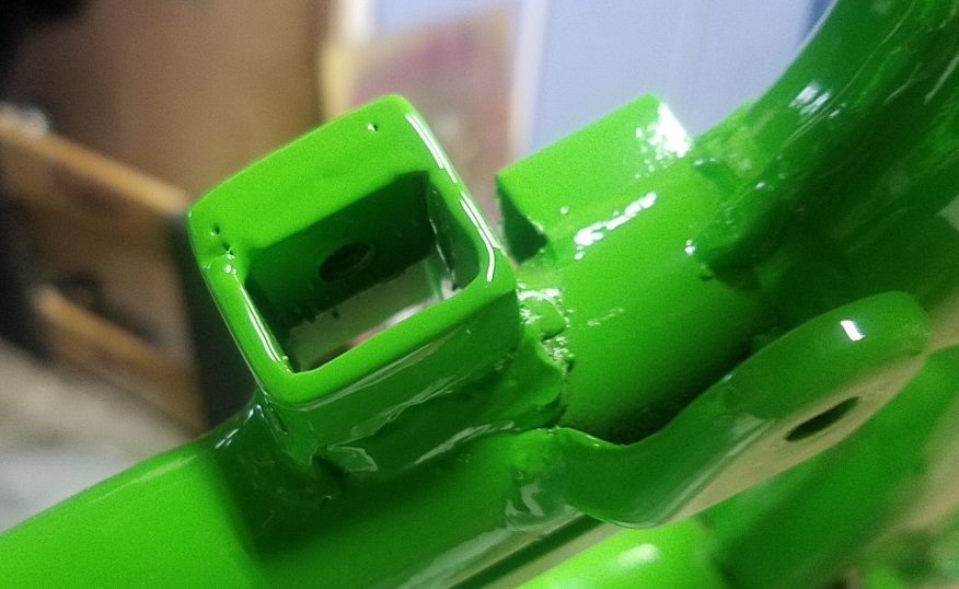

Next, I take some 1" square tubing 1/8" wall.
I mark it and cut it...
KX GURU RACING EXHAUST BRACKET REPAIR 101.jpg (179.56 KiB) Viewed 13079 times
Once I get it close to where I want it, I clean it up a bit.
Nothing crazy although you could if you wanted to.
KX GURU RACING EXHAUST BRACKET REPAIR 102.jpg (149.87 KiB) Viewed 13079 times

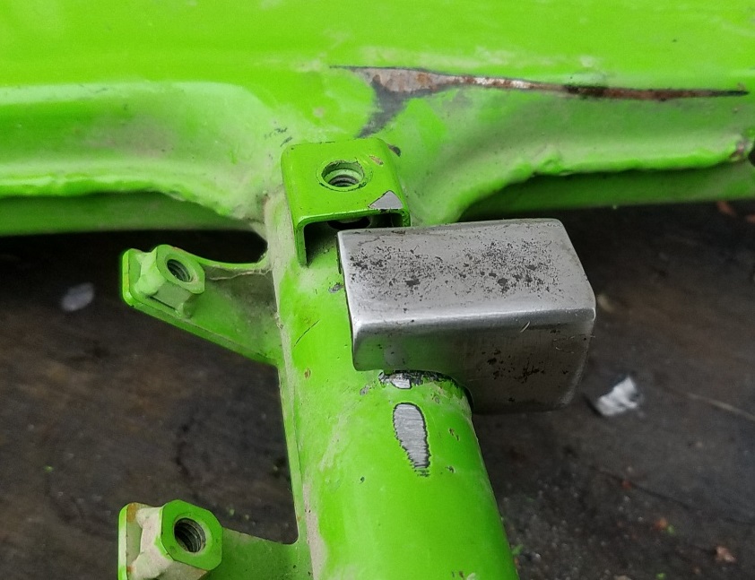

Laying the new bracket over the existing mount I use my paper template over the mount and mark the hole.
KX GURU RACING EXHAUST BRACKET REPAIR 104.jpg (114.14 KiB) Viewed 13071 times
You don't have to do this but you can weld a small piece on the inside of the bracket.
Doing this gives you more meat to drill and tap into. This will allow you to skip using a nut with the hanger bolt.
But, you can still use a nut if you choose to do so.
