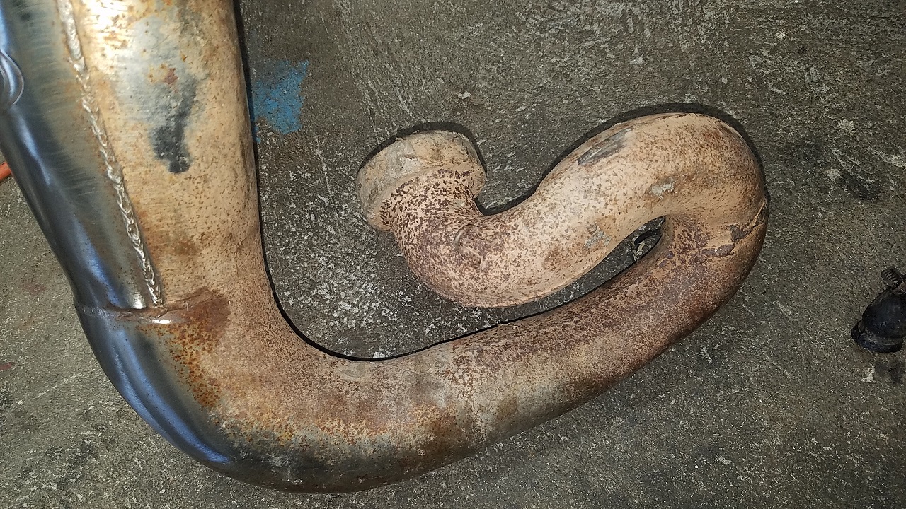

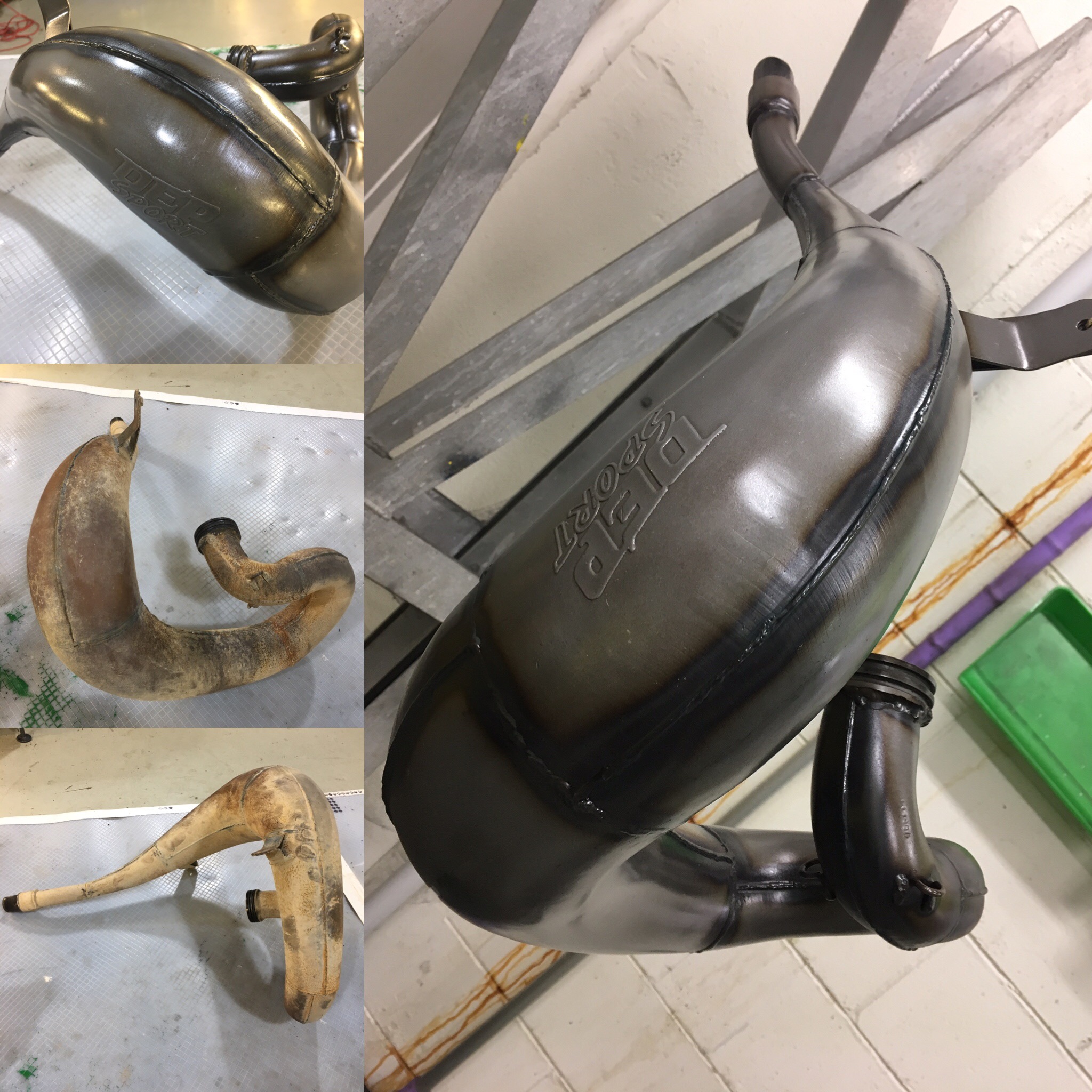

Here is a pic of a expansion chamber that is in really poor condition.
So, how do you get one like this clean?

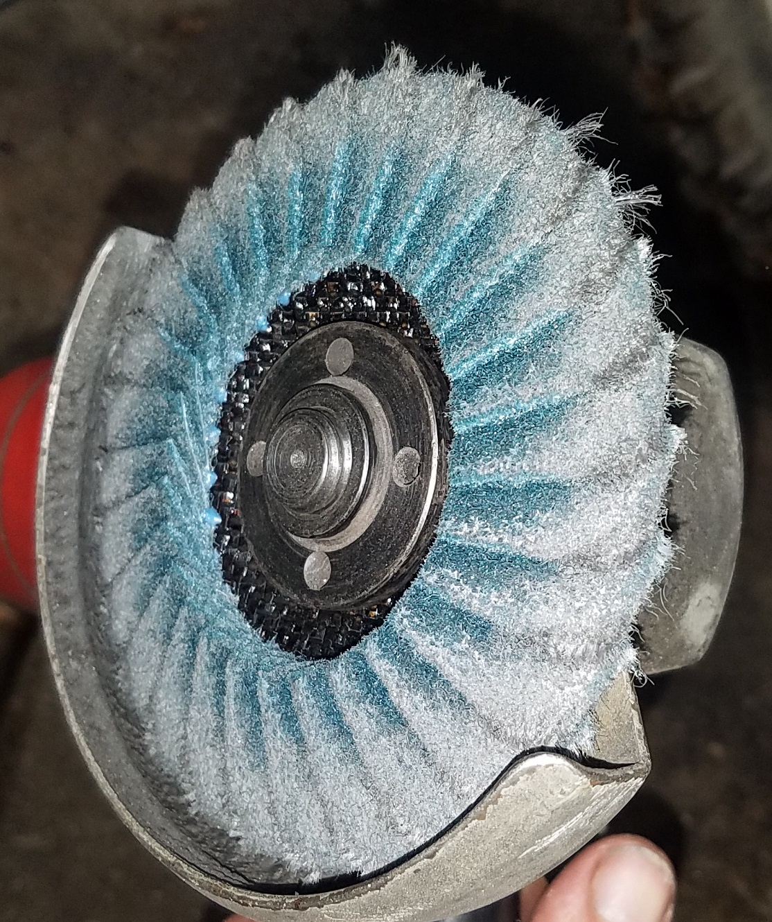

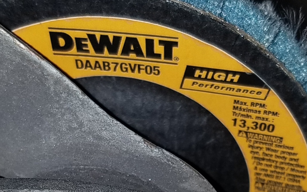

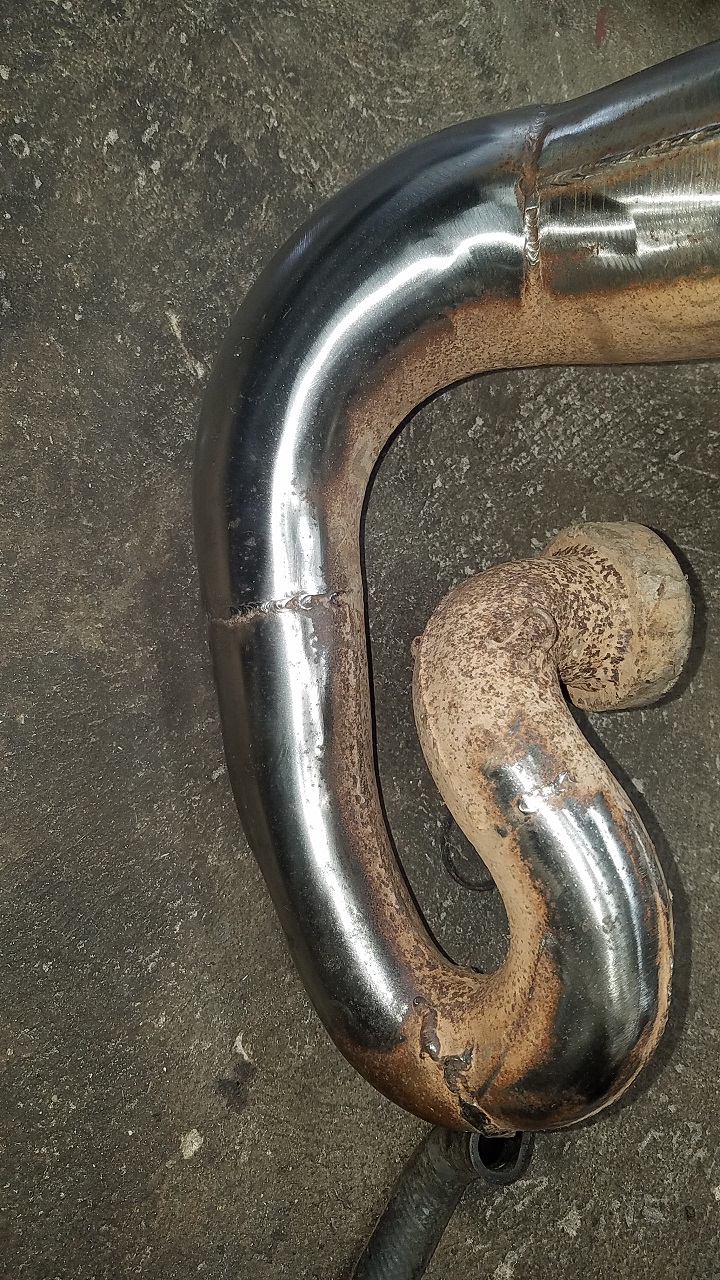

Believe it or not I got this one to this point in about 30-45 seconds..
Just need one of these..
Here is what the flapper is

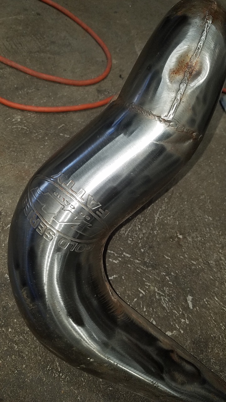

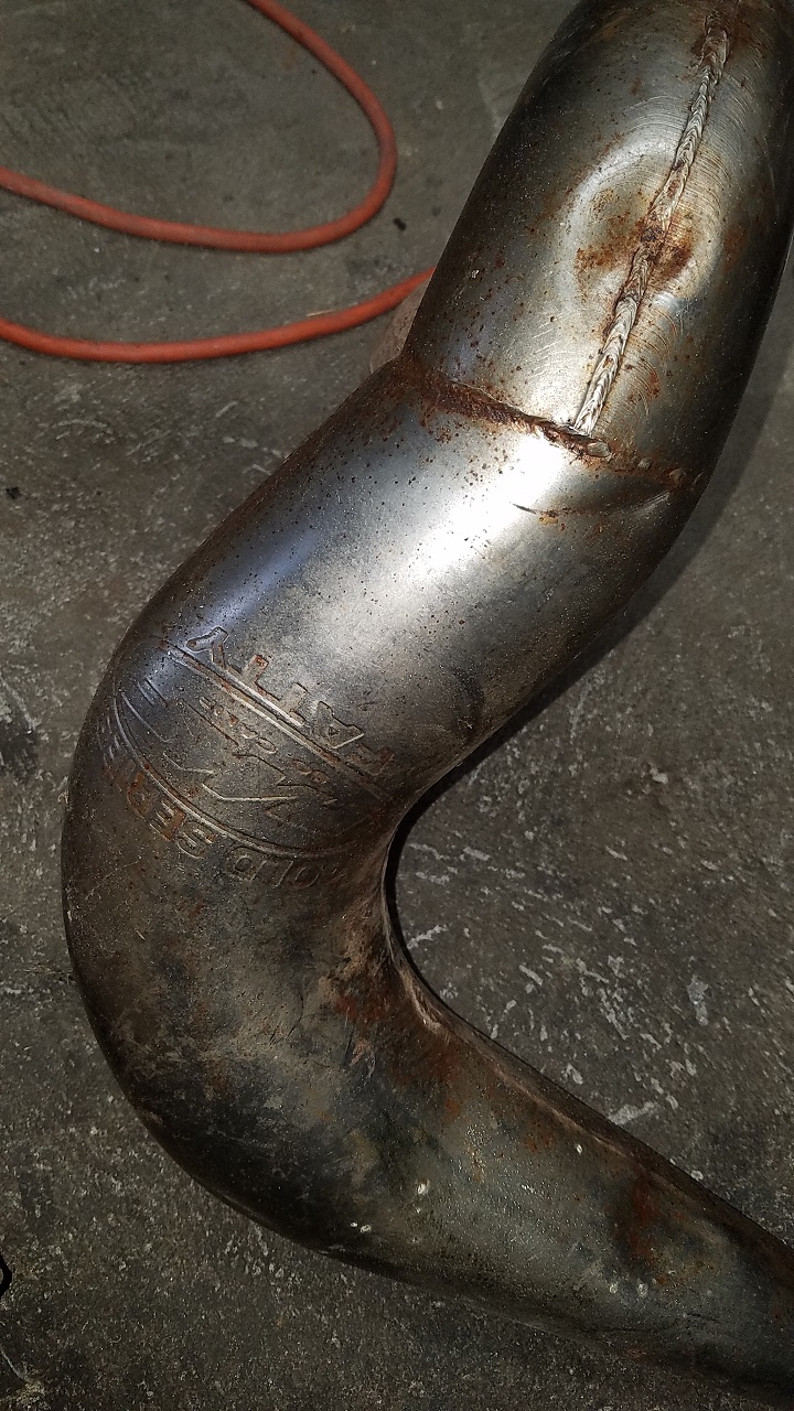

Here is another section of the pipe..
This took 15-20 seconds
