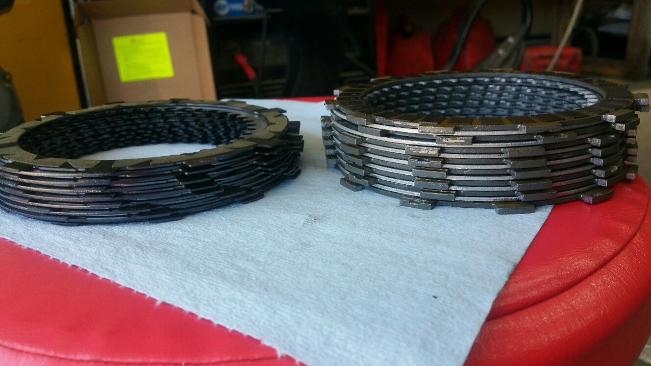

This is the stock clutch pack beside the torqdrive clutch pack
Stock clutch pack width is 33.9mm and the torqdrive clutch pack is 23.56mm. Looking good :D

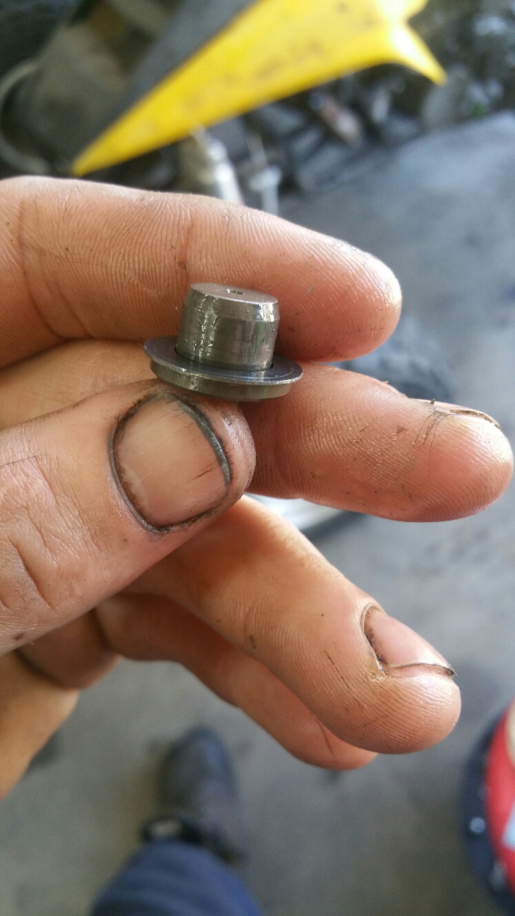

Only problem I faced was that there was no gap between the clutch plates when all the plates and exp disc were installed, so what I did was simply put a washer between the little cap that the push rod pushes on and the pressure plate, that was the only thing I had to do.
Push rod cap with stock washer
Push rod cap with stock washer and added washer

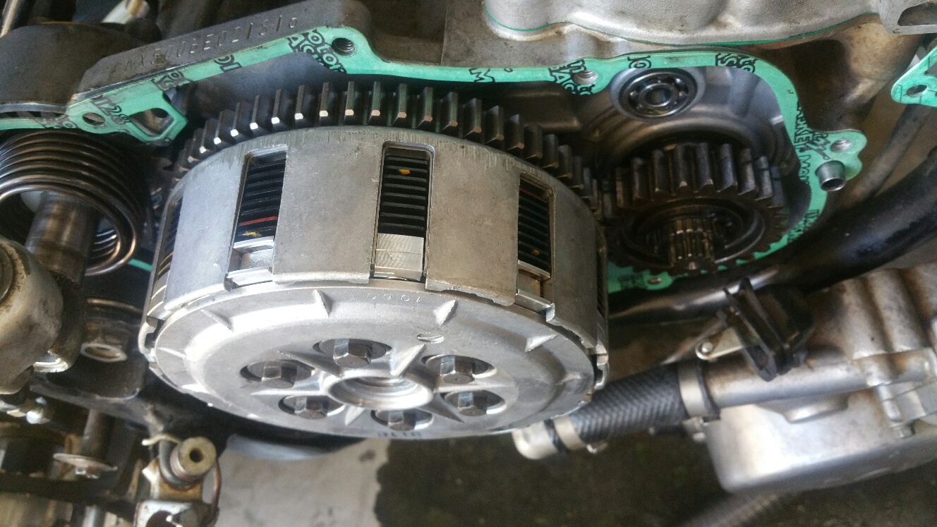

All installed
I put some grease on the heads of the pressure plate bolts and put the clutch cover on then removed it and checked the inside for grease, there was none, so I know they aren't touching, how much of a gap there is I don't know.
Another problem I encountered was that the radius x kit only came with 5 pressure plate springs whereas the KX500 uses 6, I'll have to see if I can order another one from Rekluse. I don't think it would be a good idea to use the stock springs as they are not designed to work with an auto clutch.
