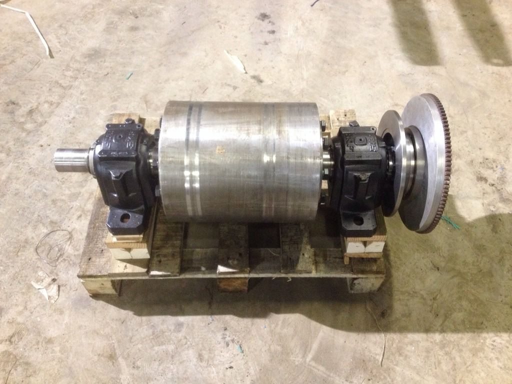

Re: Building your own Dyno

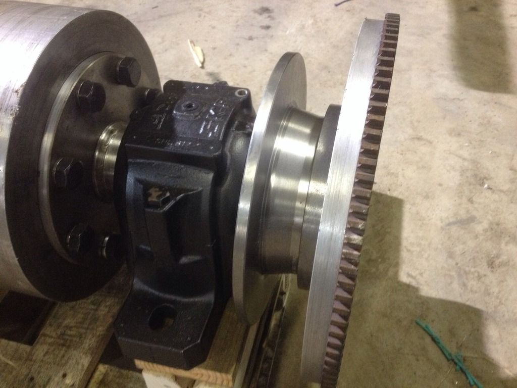

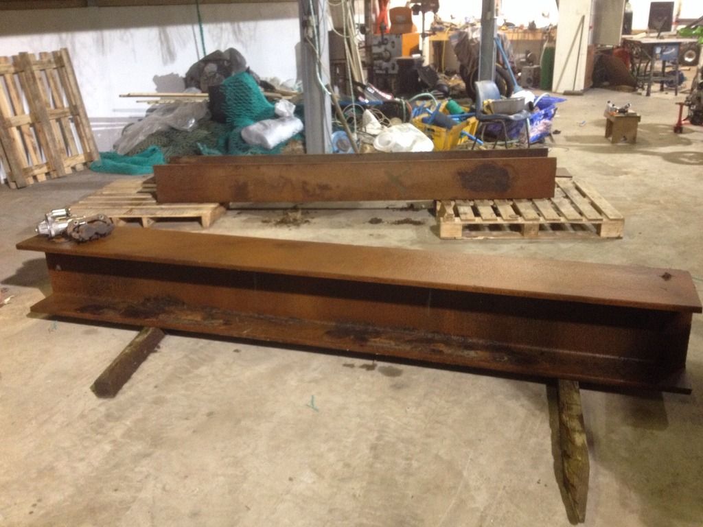

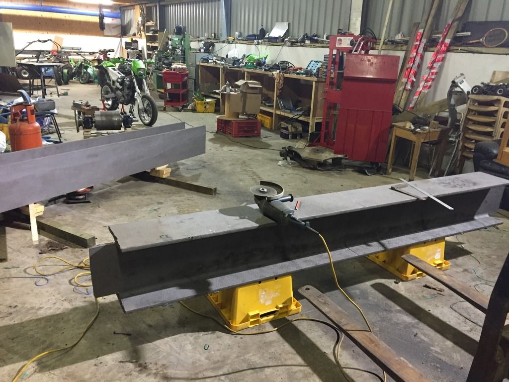

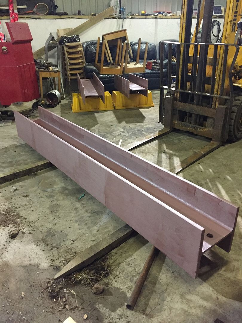

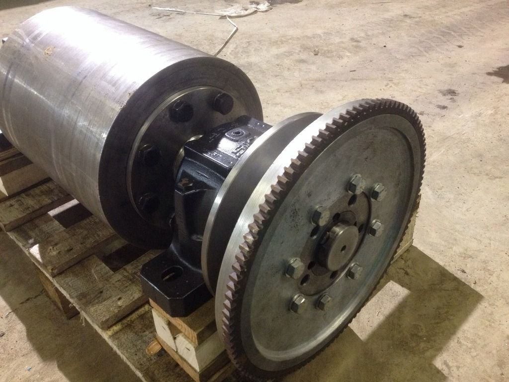

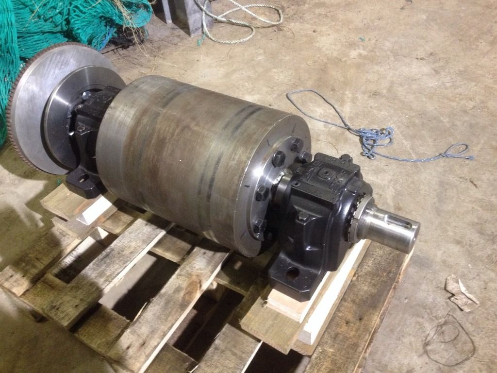

The guy made both stubshafts the same so the disc and starter ring can go at either end an can go disc first or starter ring first. This is great, it frees up the design of the chassis.
There's the roller, now the chassis is going to be made out of these two H beams. I'm going HEAVY, obviously. Beams going away for blasting.
That's all for now.
