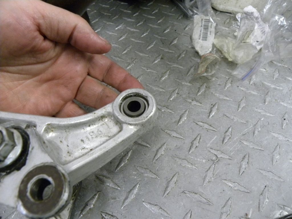

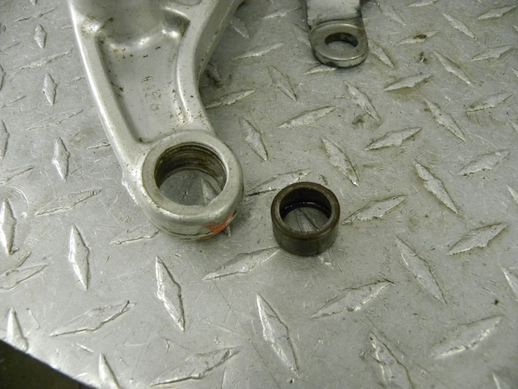

This isn't the best picture but the small bearing area is shot!
The bearing literally fell apart when I removed it.
Yet, the hole in the aluminum linkage is not oval-ed out.

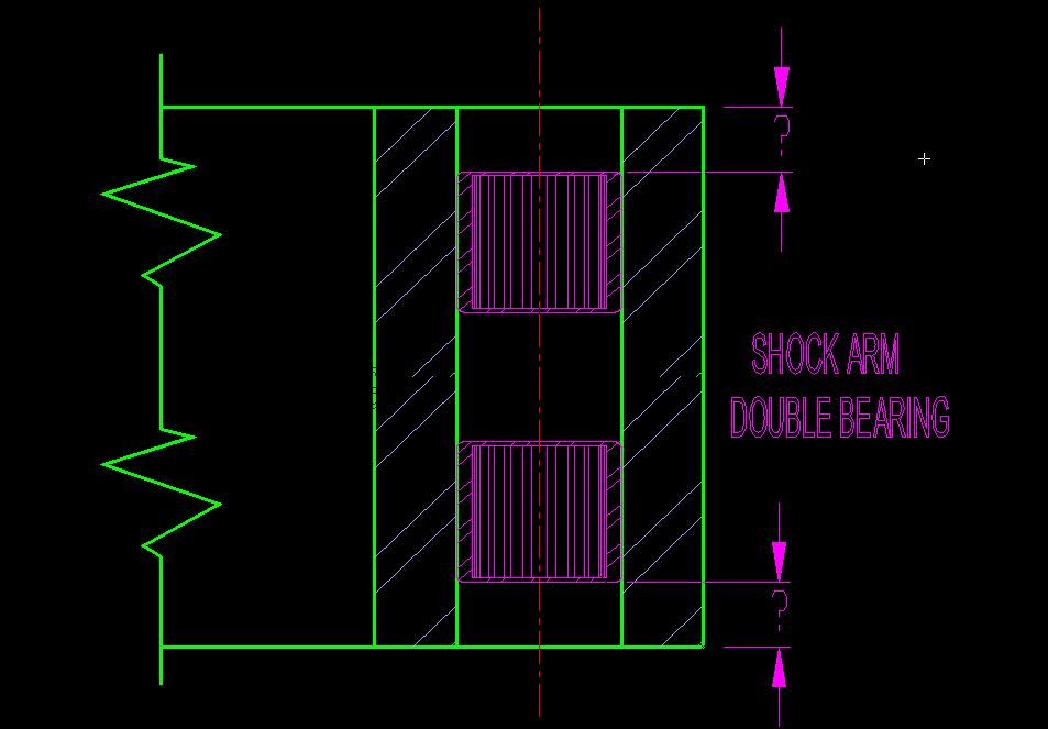

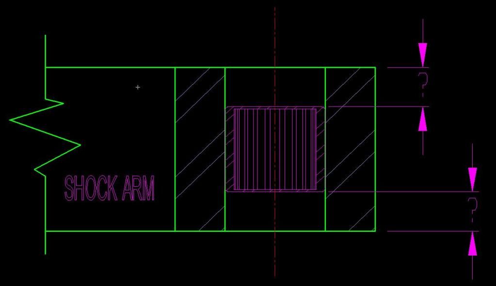

Before I removed the bearing I did one of the most important things, I measured the distance from the outside of the link to the outside of the bearing and recorded it for both sides.
If you are replacing the double bearing, then get these measurements recorded before you press the bearings out.:
I did this so that I would know how far to press the new bearing in.
This bearing is fairly easy to replace as it is centered in the hole so all you need to do is get it even on both ends.
The more centered you get it the longer and more even it will wear.
If you have a CLYMER or other manual, please consult it to verify your measurements BEFORE you start.
There is nothing worse then pressing in a new bearing only to find that it is the wrong width and now the seals don't fit.

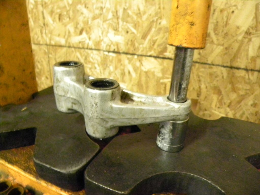

The easiest way to get the old bearings out and the new ones in is using a press.
As shown below it's an easy set up:
Note that we used two sockets, one on either side of the arm.
The bottom socket is large enough that the bearing can easily fit through it and the socket is deep enough to allow the bearing to fall completely through.

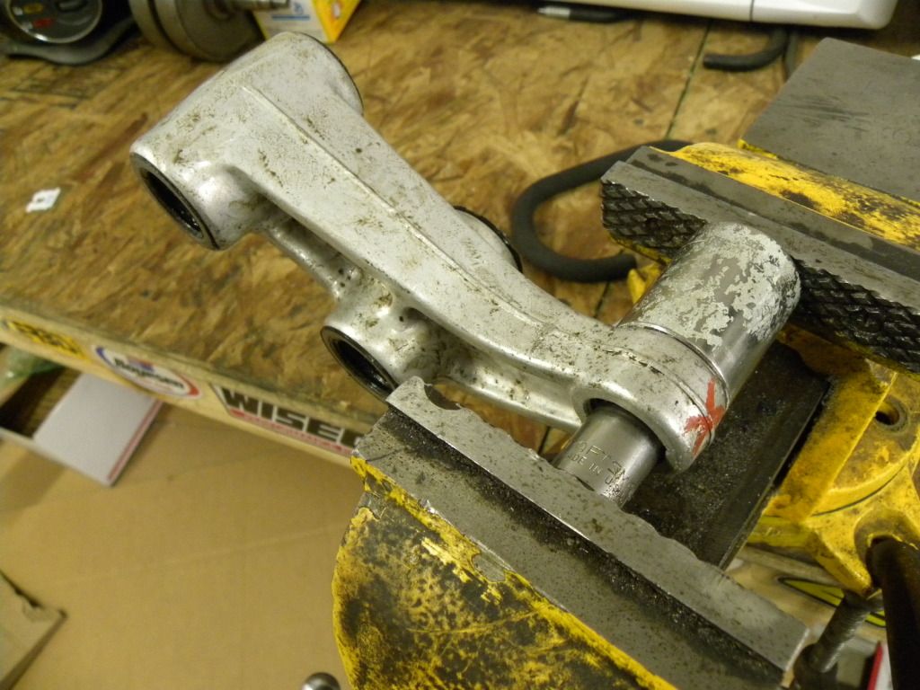

Oh! You don't have a press?
How about a vice?
As long as you have enough jaw travel it will work as shown below:
As you can see, it is the same principal as using the press, it's just a little harder to get everything to line up.

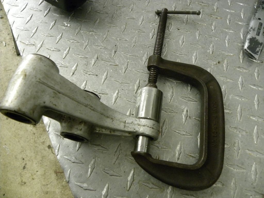

The last method I have used is the "C" Clamp method.
It works just fine once you get it all lined up.
If you have three hands it is easier.

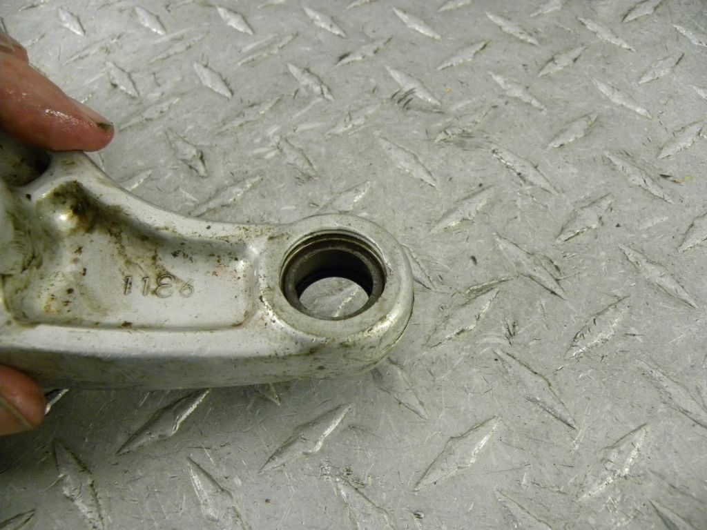

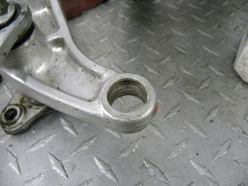

At this point you should clean and inspect the aluminum bearing hole.
Making sure that it is round and not oval-ed out is a good idea before you order a bearing.
Ordering a kit is less expensive then ordering all the bearings one at a time.
If the linkage is oval-ed out you need to order a new one.

If yours is good I can't emphasize enough how much to clean it up.

There are several ways to clean it up, steel wool, very fine sand paper, wire wheel, ect.
When your done, make sure there is no debris left behind.
Get it CLEAN!
If you leave anything behind, the bearing can get pushed in and deformed around the debris.
Then when you put the center piece in often it will bind and cause problems, including premature bearing failure.

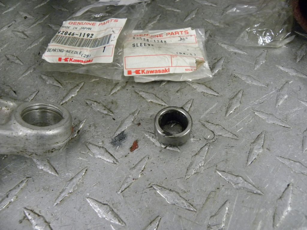

Take a look at the bearing.
See the lack of grease on the bearing?
GREASE IT!
This picture is of the bearing after it has been greased.
Once it has been greased, wipe the out side of the bearing off so that it does not have excess grease on it.
You don't want the outside of the bearing dry, but just a very fine film of grease will work.

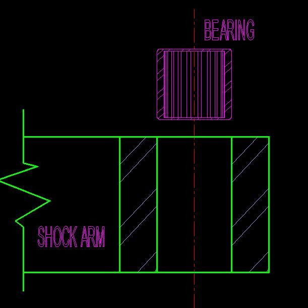

Now your ready to press the bearing in.
To press the bearing in, find a socket outside diameter just barely fits into the bearing hole on the linkage.
The closer the fit, the less chance you will have of damaging the bearing.
So here is what you have, a bearing that needs to go into a hole.
It's a light press fit so you won't be able to put it in by hand.
You must use a press, vice, or "C" clamp.

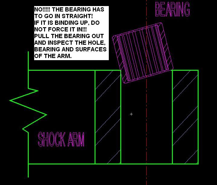

The bearing needs to be fed in straight!
You do not want it to start at an angle as you will damage your bearings.
Below is a picture of what you don't want to do:
If the bearing is wanting to feed in at an angle, take another look at the arm.
Mark sure it has no burrs or debris.
